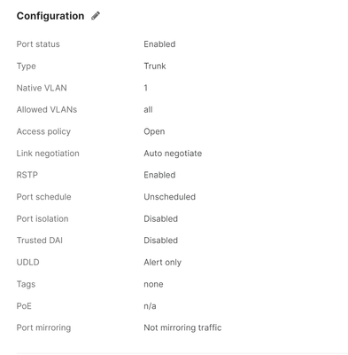

agionet
How can I verify if that was the case? The SFP+ port on the primary switch still shows as enabled:
I've also tried multiple SFP ports on the secondary switch to no avail.
The primary switch is set as bridge priority 4096 in switch settings. All other switches would have default bridge priority.
GIdenJoe
And what is the switch and SFP on the other side of the fiber link?
