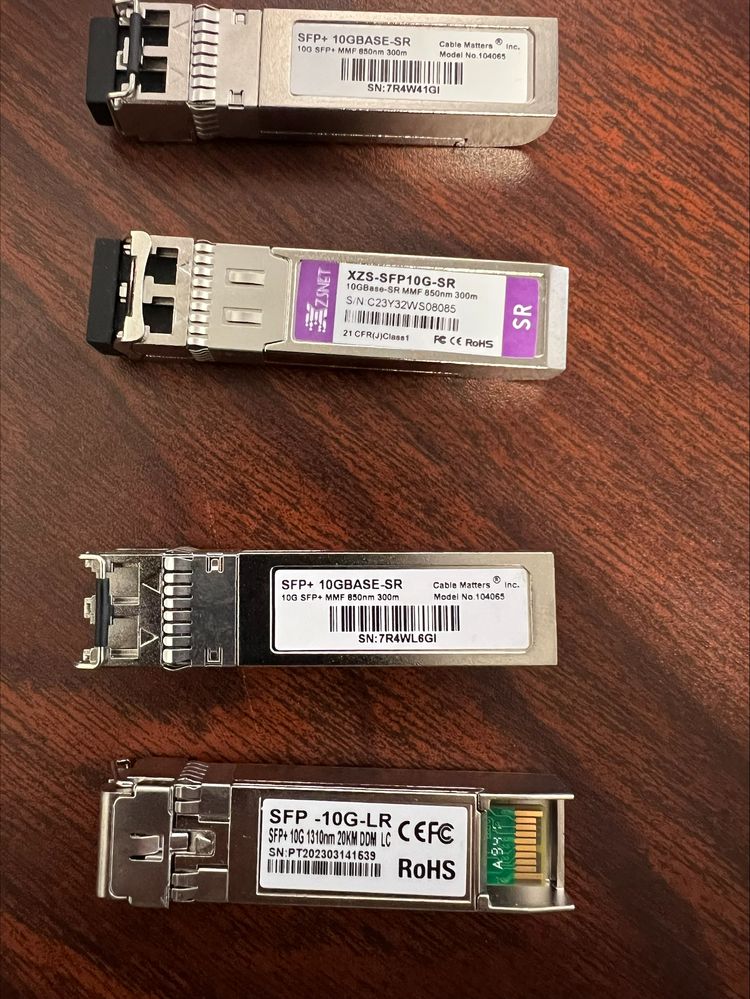

here are the types of SFP i am using, and I believe its a OM3 fiber cable, it was ran by a 3rd party .

Is the cable run less than 300m, if so the top three are suitable, but none are Cisco models, so might not work.  When you plug them in to the port do they show up on the dashboard?

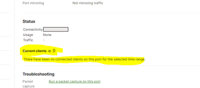

click into the port and go down to the Status section and post the picture here,  As you can see the one I have is disconnected, but shows the transceiver type plugged in.

HectorM
if there was ever a connection, I would have a number here?
HectorM
all 4 have that same

No, that is only right now.

Those are 10GBASE-SR (except the one at the bottom which is LR).
