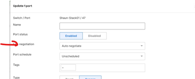

How about link negotiation?
BlakeRichardson
That was going to be my suggestion is link negotiation, it should be set to auto by default @FredS however you could try manually changing it bear in mind you have to do this at both ends.
If this resolves the issue it could be driver related.
