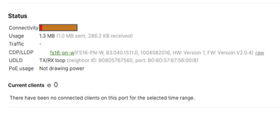

I have a status on port 8 like below:
If I click on connectivity status bar I can see that port is disonnected:
I have already disabled  and enabled this port. What does the brown colour mean? Any ideas what can I do to make the port up and running?

Looks udld related. Make sure the fibers are connected / correctly
Udld
Mloraditch
The port is indicating a UDLD TX/RX Loop: https://documentation.meraki.com/MS/Other_Topics/Unidirectional_Link_Detection_(UDLD)
As your CDP info shows a switch connected to that port you likely do have some sort of loop you will have to track down. You may be able to look at all the CDP/LLDP neighbors in your meraki switch ports to find it, but you may also have to get into that switch and trace further as the loop could be further downstream.

The port has been disconnected. Nothing is plugged into it
But there is still Ewon's modem name in the status:
Mloraditch
CDP/LLDP info in the dashboard doesn't clear instantly like on IOS devices. I've seen in the past it take up to 48 hours for the old info to clear out.
