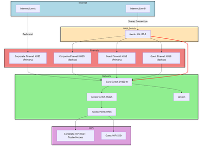

Hi everyone,
I’m looking for advice on the best way to connect and secure an MS-130-8 WAN switch in our network. The network diagram is attached at the bottom of the post.
Network Overview
  • MS-130-8 Role: The switch serves as a WAN breakout switch, distributing internet connectivity between the corporate and guest networks.
  • Internet Lines:
    • Internet A: Dedicated for the corporate network.
    • Internet B: Serves as a backup for corporate traffic and primary for guest internet.
  • Firewalls:
    • Corporate Firewalls:
      • Primary Firewall: Connected to Internet A.
      • Backup Firewall: Connected to Internet B.
    • Guest Firewalls:
      • Primary and Backup Firewalls: Both connected to Internet B.
  • Current Connection:
    • The MS-130-8 is connected to the core switch (C9300-M), which aggregates traffic from the corporate and guest firewalls and routes it to downstream devices, including the access switch (MS225).
We aim to securely connect the MS-130-8 to the Meraki dashboard for management while adhering to best practices for security and reliability. Additionally, we would like to avoid assigning a public IP address to the MS-130-8 unless there is a compelling reason to do so.
Questions
  1. Secure Dashboard Connectivity:
    • What is the best way to securely connect the MS-130-8 to the Meraki dashboard without using a public IP address?
  2. Core Switch Connection:
    • Is it advisable to keep the MS-130-8 connected to the core switch, or should it be connected directly to the firewalls instead?
  3. Best Practice Configurations:
    • How should VLANs and firewall rules be configured to isolate management traffic while allowing dashboard communication (e.g., HTTPS on port 443)?
    • Should we use separate physical connections for management and WAN breakout traffic, or is a single trunk link with tagged VLANs sufficient?
We’d greatly appreciate any insights, recommendations, or references to Meraki best practices. Thanks in advance for your help!
Personally, I'd give it a static public IP address and have no connection to the internal network.  I would also disable the local status page.
In addition to what others have mentioned, if the swtch can only connect to the Meraki cloud via an internal path that ultimately connects through itself, and you have a mis-configuration, you wont be able to fix it via the Meraki cloud as it will have cut its own in-direct access off.
If it can connect to the Meraki cloud directly then there is no risk of human error bringing everything down.

I would pull the Meraki Manangement interface out as a single vlan on an Access port, to ensure you don't risk getting WAN traffic L2 broadcasted into your core.
Since Meraki also does Application Visibility stuff, I would also put the MS130 as a WAN switch in its own Meraki Network, thus not mixing it with the rest of your enterprise network. This allows you to patch your company switching layer irrespective of patching your WAN switch.
That being said, there's some discussion on whether to use a managed switch as a WAN switch compared to using an un-managed. Some prefer one over the other, with pros and cons.

There is a third option that I prefer: Use a managed non-Meraki WAN switch like the C1300-8. I always connect this device in a dedicated MX-DMZ to control what's allowed and what is not allowed.
KarstenI
If you wonder why I want to have this device managed, it is mainly for monitoring/logging and, as a result of these, central authentication.

Hi @rhbirkelund, @KarstenI, and @PhilipDAth,
Thank you all for your valuable insights! I really appreciate the time you took to share your recommendations on how to best connect and secure the MS130-8. I wanted to share our planned approach based on your feedback.
Planned Changes for Securing the MS130-8
1️⃣ The MS130-8 remains a managed WAN switch (no changes in hardware).
2️⃣ Local Status Page will be disabled by default for security.
3️⃣ Emergency access to the Local Status Page will be restricted to a single port on a dedicated Management VLAN
4️⃣ Firewall rules will be put in place to restrict management access, blocking unauthorized traffic from other VLANs.
5️⃣ Meraki Dashboard connectivity is currently routed via the internal network, but we will first check if we have spare public IP addresses available before deciding whether to assign one.
Thanks again for your valuable input—I truly appreciate the expertise and best practices shared by the community!
