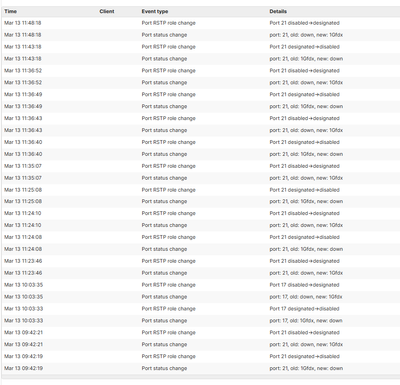

We're experiencing frequent RSTP role changes, but no BPDU events are logged anywhere in the Dashboard.

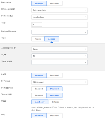

All of my client access ports have RSTP & BPDU enabled, example config:

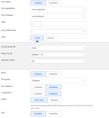

The links between switches are set to trunk ports, example config:
We have some additional trunk ports for devices that need to access multiple VLANs, e.g., wireless access points, meeting room devices, NAS, hypervisors, example config:

michalc
You are experiencing port flapping on port 17 and 21. Please verify physical layer. I recently described the event logs seen in my other post.

agionet
Hi Michalc,
The flapping is happening to many ports across all switches. End users are complaining about slow download speeds, and the dashboard throughput tests to the core switch (SW-MS225-1) only show 10Mbps when the MX84 dashboard throughput test shows 250Mbps, which prompted me to review the event logs.
The only other thing I can think of is these end user ports are connected to Microsoft Surface docks - could the flapping be happening when users disconnect or connect their laptops to the docks?

On first glance stp guard is set to disabled on the uplinks between your switches
set to root guard from core to edge and then loop guard on the links back to your core.
