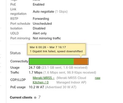

There was a new beta switch firmware release last week, the release notes are below:
However on an MS220-8P I have, the port that connects to an MR55 running 26.7 downgraded to 100Mb with the warning below, so I downgraded the switch to 12.9 and it is back at 1Gb.
