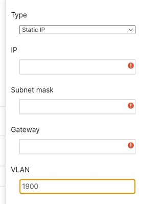

The management vlan is set to a specific vlan of 1900. When I first configured the switches I assigned them a static IP within this vlan before testing in production with our firewall. All it was connected to when I configured IP was another meraki switch just to get it setup.

So port 5 of the switch allows tagged vlan 1900.
And switch management has 1900 set in the vlan field?
