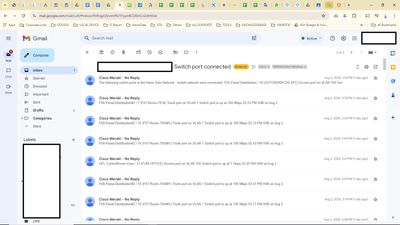

I get a lot of emails about this case

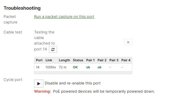

Have you ran the "cable test" function on each of those switch ports to identify a cabling issue like @DarrenOC recommended?

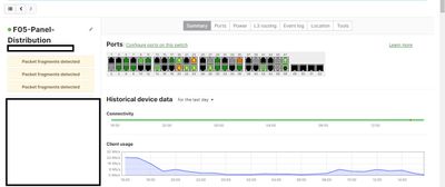

CRC.jpgI don't think this is a problem with the cable, because this case only happened now

I have changed it to manual and it is 100Mbps full duplex.
It is reporting that only 2 of the 4 wire pairs are connected.
Pairs 3 and 4 are not connected up to anything.

I use an external POE adapter so it doesn't affect pair 3 and pair 4.
cmr
Gigabit connectivity requires all four pairs, if one is faulty then only 100Mb can be reached.  If you bypass the PoE adapter and connect a laptop or similar, does it connect at 1Gb?  What model is the switch?  What PoE adapter are you using?
cmr
If you can't connect at 1Gb then there is a problem with the cabling.  Do you have a cable tester?  What category of cabling is it CAT5 unshielded etc.?
