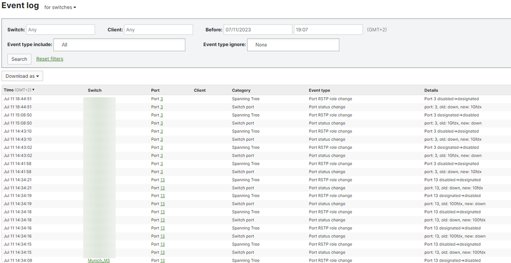

I see many events in the Event Log for the switch (Port RSTP role change)
*Attached picture.

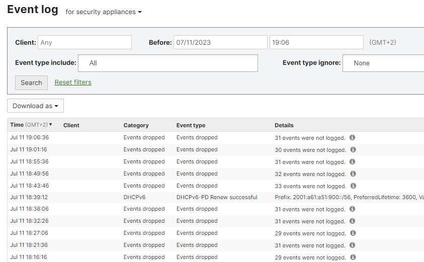

Moreover, I can see in the Event log for the security appliancechrome_zcBtso1s0X.png many Events dropped (Pic attached)

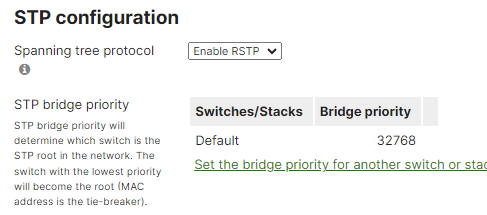

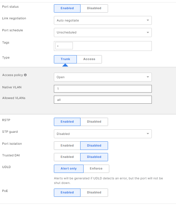

For the switches, the "STP configuration" is Enabled (Pic attached)
Any idea how to start the diagnosis?

Another thing I've noticed is that STP is changing on ports 3 and 13, what exactly is plugged into those ports?

Regarding the STP change on those ports, Port 3 - is a PS5 (Console) - currently turned off.
Port 13- Is a Lenovo Workstation - is currently up and running, but it seems like its port speed is 10Mbps - Dont know why; maybe a local issue with this Workstation.
It makes sense that the speed is slow if the port is negotiating at 10Mbps. So this could be a problem with the cable or the network card itself.

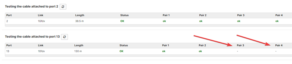

I ran the Cable test on the ports.
The 10Mbps port cable seems damaged; I`ll have the user replace it!

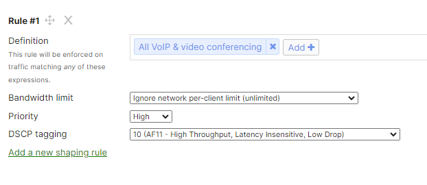

Regarding the traffic shaping rules, we have a "Per-client limit' for 50Mbps, & "SpeedBurst " is enabled  (I was advised to keep it on, What do you think?)
Moreover, we have the following rule applied: ( VOIP traffic priority set to High)
I believe that by changing the cable your problem should be solved and 50Mbps seems to me to be a good number, of course it has to take into account the amount of traffic that is generated on your network, but it seems good to me.

I tried to Cycle this specific port, but again it is still 10Mbps, + the Cable test is not ok.

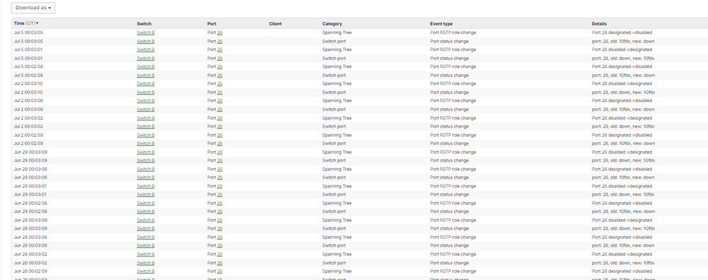

I have another site, that has Two MS120 switches there. (This is the site I work at and have physical access to the equipment)
I can see there also many RSTP role change for multiple ports (One of them I see the cable is not good, and I`ll have it replaced tomorrow)
But for the rest of the ports with the RSTP role change, the cables are ok (According to the test from the dashboard).
Do you recommend replacing them either way (since U said I should count on the cable test from the Dashboard).  - it is a VOIP equipment (Logitech MeetUp).

All these events of ports going up and down could be simply that the machine is going into a sleep/eco mode.
Like alemabrahao said , that could also be a layer1 issue with your cabling.

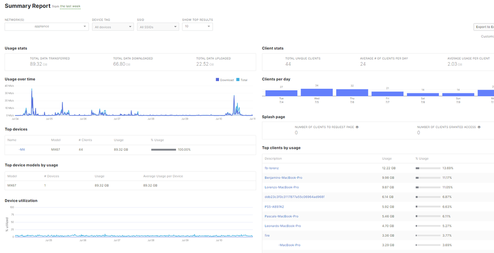

That many dropped events on your mx does not look good. What firmware are you running? What is the utilization of that mx. https://documentation.meraki.com/MX/Monitoring_and_Reporting/Device_Utilization

The Current (MX67) version is: MX 18.107.2
The utilization is as follows  (Currently, the users are not working, all are at home) - and overall it seems that it`s very low
What do you recommend?
ww
Summary looks fine. If your problems started after a firmware upgrade you could try downgrade.  Or create a meraki support case to figure out what the cause  of the dropped events is
