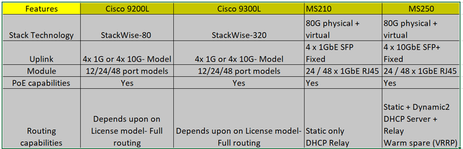

I just want to be sure I am comparing appropriate models, which I believe to be (but need people to confirm explicitly);
MS210 - 9200L
MS250 - 9300L
My planned design is a 2x MS250 stack, with 1G fibre uplinks to MS120 switches around our site.
Many thanks.

@Eds89 depends what functions you’re wanting to use on the Cat 9200L. If you’re looking to do anything clever like SD-Acess then you need the Cat. Otherwise if you’re looking for ‘normal’ Layer 2 switching and a small amount of Layer 3 static and connected routing then either the MS210 (with 1Gbps SFP ports) or MS225 (with 10Gbps SFP+) ports should be fine. If you’re looking at redundant power supplies or OSPF then the MS250 is the most cost effective Meraki switch.
With the Meraki solution you also need to consider the ease of management, reporting and troubleshooting assistance that the Dashboard provides you. In the Catalyst world you don’t get anything similar unless you add a DNA Centre to your solution (which isn’t cheap).
EDIT: You could also use a MS210 as a replacement for a Cat 9300L if you don’t need the redundant power supplies and can make do with a small number of static and connected Layer 3 routes.

The costings were fine, I was just curious on the models that clostest resembled each other from each manufacturer.
This was so that when we compiled our pricing, we were comparing the most like for like setups possible.
When comparing the MS250 to the 9300L and the MS120 to the 9200L, the total costs came out pretty much the same for both setups, which to me suggests those model comparisons are accurate.
