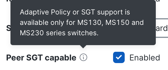

Wondering if the Meraki MS230 Series is coming.....? 😎
Ryan_Miles
Meraki Employee All-Star
Pretty sure the 150 was supposed to be called the 230 originally. This might just be a UI goof.

RWelch
Ah, good to know info.  Thank you.

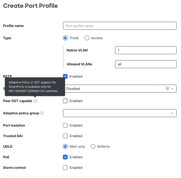

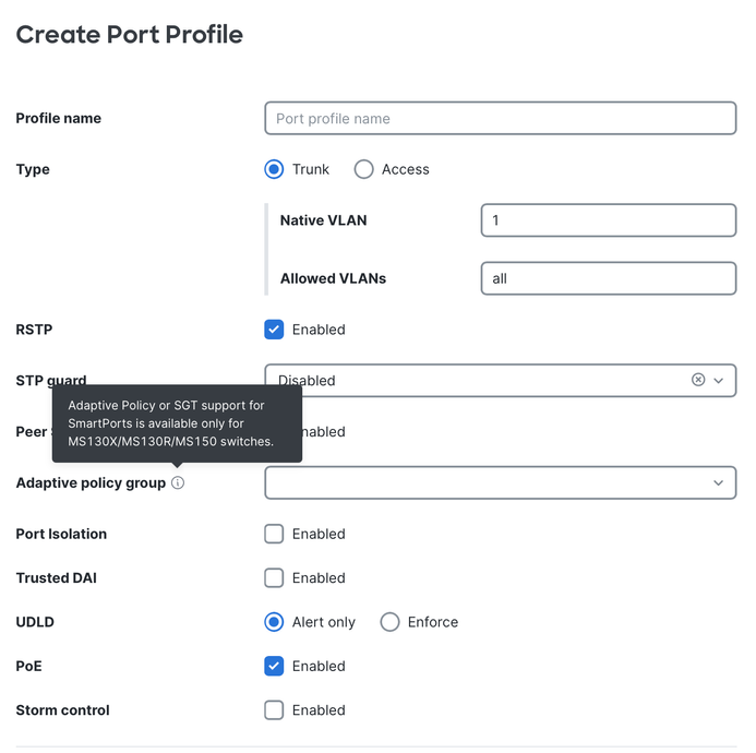

RWelch
Update: Indeed turns out to be a UI goof - and it's been fixed in the dashboard (yay)!
Another kudos to @Ryan_Miles  👏 👏 👏
