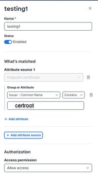

So I did that, I imported my CA certificate (intermediate and root) inside of access manager.  I then setup a rule that uses the issuer - common name (for testing) as an allow rule.

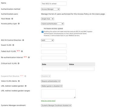

I then went into the switch -- > Configure -- > Access policies and created a new policy using "access manager" as the authentication method, Host mode "Single-Host", and "Hybrid authentication", as I will use MAB to authenticate our phone vlan.

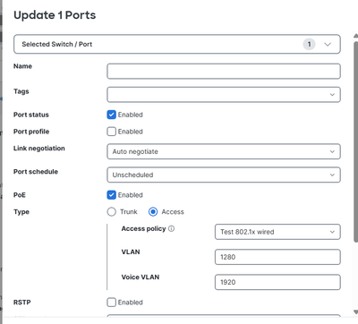

I then went to the switch port, and added this new access policy to the port.

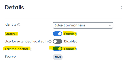

Also under certificates, make sure your root CA is configured to be a trust anchor.
Use the three dots on the right hand side and ...

the switch name is SW255 - so in the meraki portal under 'switching' -- > 'configure'  -- > 'access policies' this is where I defined my access policy 'Test 802.1x wired', the authentication method is Access manager, host mode 'single-host' (recommended by the demo video, the the access policy type I set to 'Hybrid authentication' as I will use MAB for the ip phones and I will input the mac addresses into meraki (in my lab environment I ONLY have a laptop setup).
next comes the certificate, I imported and merged our root and 2 intermediate certificates (as we have 2 CA certificates), I initially had the intermediate certs set to active and the anchor, but per your recommendation I have set the root cert as the anchor.   below are the details (names have been edited)
next is the access rules - inside access manager -- > policies -- > Access rules, I created a rule called "testing1", where I associated the name that contained "certroot" to allow access
 last step was assigning the port the access policy "Test 802.1x wired" , on SW255 port 4
