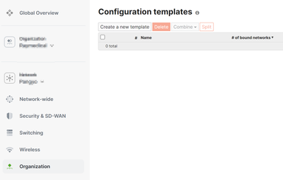

Arthamon
I can confirm after viewing two of my networks, one bound, and another not bound that this is the likely case here.
