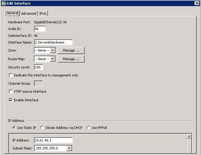

Hi MRCUR thanks for your reply
below asa interface (i have vlan 4 this is another vlan as example) and the meraki switch port

Re: Cisco ASA 5508 in combination with a Meraki 225
In the ASA screenshot the VLAN ID is 46 - not 4.
Highlighted
Comes here often
Correct is an example of an other asa
