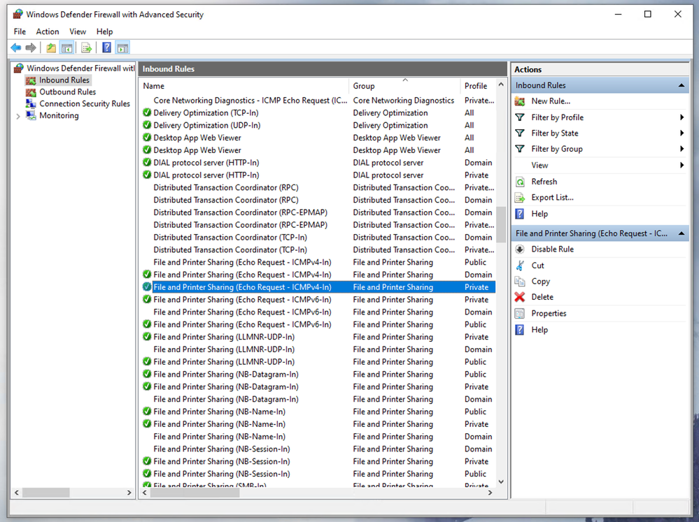

@TroyV I wouldn't disable the firewall just to fix this issue, you need to allow inbound ICMP traffic. Doing that will allow you to ping said device while having it's firewall active. Just make sure you select the correct rule for your network type i.e. private, domain or public
