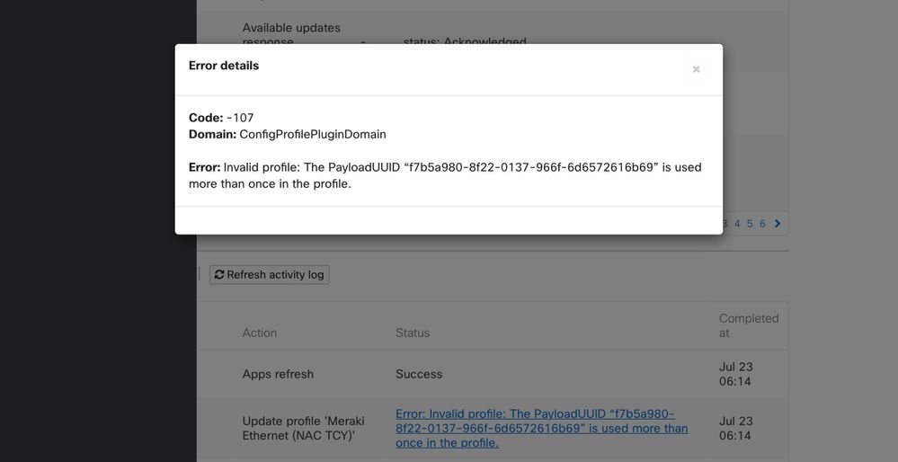

Hello,
I configured the NAC on MS switch with sentry .

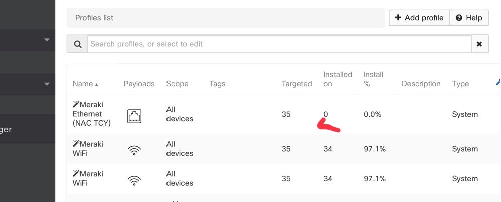

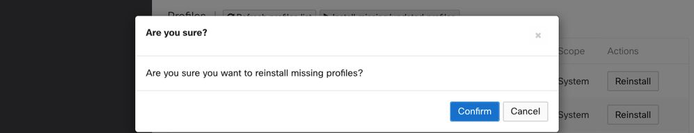

- The profile doesn’t seems to be pushed automatically , I need to clic on reinstall profiles in order to see something in the logs.
- The profile ( certificate ) is not pushed to the device and I have this error on all device :
- all macOS are affected , it works on AppleTV but need to click on “install missing profil for it to be pushed.
- We are using sentry also for WiFi (802.1x)
Update profile 'Meraki Ethernet (NAC)'
