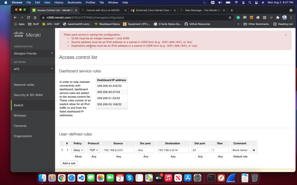

ACL for IPV4 is not available
I'm trying to add a simple ACL rule and I get an error message that the source and destination must be IPV6. My network is an IPV4. Here is a screenshot of the rule and error message. Any idea how can I add an IPV4 rule?
Thank you.

i was going to suggest the same. almost all the switches were on ancient firmware from 2017 and that's likely the issue.

No. There are no trailing spaces before the subnet. I just heard from Meraki support that I need to upgrade the switch firmware. I hope this fixes the issue.
