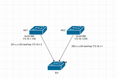

We have TWO MXs configured with multiple VLANs.  I need to a device to access device across the MXs.  Is this possible without adding the VLAN to each MX?  Sorry if this is confusing or I am not explaining properly, but I am attaching a diagram to help.  Thank you for your help.
No, the subnet must be the one you want to access from the peer side.
Like the image I sent, if on the MX1 you want to reach the 100.x.x.x network that is on the Mx2 then your route has to be as follows.
Subnet 100.x.x.x/24 (just an example) next hop 172.16.1.2 (MX2 interface IP).

You need to add routes on each MX, but for that each MX needs to be on a link VLAN to be able to point the next hop.
So you can create vlan 999 (for example) with a /30 address on each MX and then just add the static routes.
Or just configure  SD-WAN.
If you consider using SD-WAN (in my opinion it's the best way) don't forget that one of the MXes must be the HUB.

Yes, but you need to have a common VLAN on each MX with a configured IP, to point the next hop.
Some thing like this.

I configured the common VLAN with a uniquire Gateway IP will save no issues.
The issue is now when I add the static Route, I use the subnet of the VLAN and next Hop IP, I get the following message:
  • Static lan route subnets cannot be contained by (or be equal to) a VLAN subnet.
Which subnet should I use when adding the static route to MX 2?  MX 2 is where I am adding the common VLAN. In your example I am using the VLAN 999 subnet 172.16.1.0/30 next hop 172.16.1.1
On MX1 I just added static route 172.16.1.0/30 next hop 172.16.1.2, this saved without error.

The two MXs would need VLANs with unique subnets to make this work.
