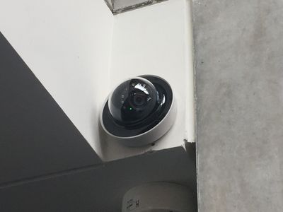

BlakeRichardson
@Kenny_Benzing I am guessing for your cameras to be affected by rain they are mounted vertically?  Using the optional mount might give you a better picture in bad weather.
Kenny_Benzing
I'm not sure what you mean by mounted vertically. We are using the Meraki mount for the MV72 found here and I was under the impression that they are only designed for wall mounting?
What optional mount are you referring to?
BlakeRichardson
The attached image is a vertically mounted camera. The mount you linked to is optional, you don't have to purchase those mounts if you don't want / need to.
Kenny_Benzing
Thank you for clarification. No, we do not have any cameras mounted that way.
