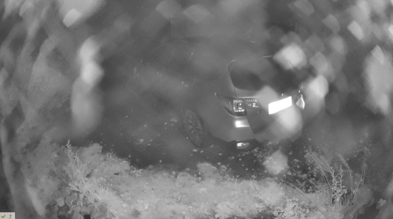

Here is a picture taken when it was raining earlier, but is actually not even raining now:
I haven't blanked out the number plate, that's what the infra red does, massively over saturating the image on both models.
I wish the infra red could be turned down and there was an accessory 'hat' to protect the lens from the rain.

There is a light on the wall about 30cm above it, but even with that on, it doesn't provide enough illumination to take the camera back to daylight mode and I can't put a brighter light on as we are in a dark skies area where you are not allowed very bright outdoor lighting...

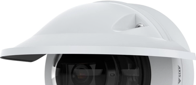

This is the sort of thing I am looking for:
I know the camera in the photo (I worked with Axis cameras for many years 😄 ), but I don't know of any third party vendor that provides this same type of accessory for Meraki cameras 😞

I agree for the price that MV cameras are not great at night in bad weather, I've had no end of problems with motion alerts and rain drop. I've spent hours fine tuning sensitivity settings and duration to try and find that sweet spot.
Disabling IR and relying on other artificial light has been the best solution I've come up with.

Firstly (and I'm sure you've done this), make sure you remove the protective plastic dome that the MV ships with, the one with the tab with the ⚠️ on it.
You may find some success with hydrophobic coating such as RainX or Gtechniq G5 Water Repellent Coating
which is used for motorcycle helmets or car windows, we don't officially endorse any but any coating that doesn't harm plastic or glass should do the trick to help prevent moisture or water droplets from clinging to the outside of the dome.

Is there any way of 'turning down' the infra red power?
ConnorL
Meraki Employee All-Star
It's on or off unfortunately.
