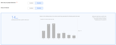

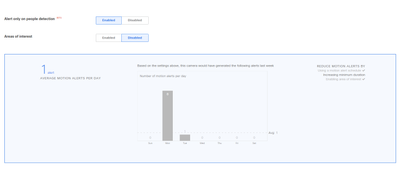

I have attached two screenshots - One people detection enabled and one people detection is disabled.
As you see when I enable the people detection my lots of unwanted alerts get dropped.
Is this not the right approach...However, in my case rain or strong wind is also generating motion alerts.

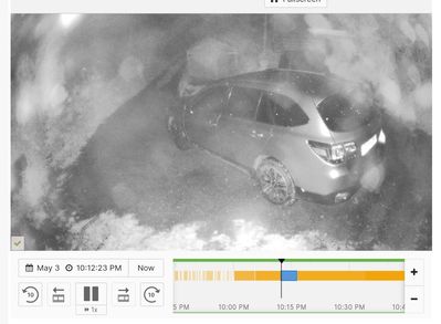

I'm seeing the same on a 72X with the latest firmware tonight. 60 alerts in less than two hours and it's not raining much.
People detection is also on and I did have 3s and 30% sensitivity. There is literally nothing going on apart from the light rain...
I have increased to 5s, but really not sure why it is so bad!
Looks like 5s has stopped the rain emails, perhaps people only alerting doesn't work with a 3s minimum?
