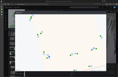

I monitor cameras on multiple locations. I uploaded floor plans and placed the cameras on the uploaded maps, but I am the only user who has the floor plans showing up, and even then I usually have to refresh my web browser to get the map to appear.
The map that shows up in Meraki Vision for other users is the google map with no floor plan. The cameras are placed where they should be, but it is basically useless without the floor plan.

The image below is what the other (non-me) users are seeing for the map.

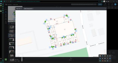

This last image is what I see and what I want everyone else to see.

I have Organization level privileges, and the other users just have camera network level privileges. I looked all over and I cannot find a setting that applies to floor plans and maps (could have missed it).
I don't want everyone to have Organization level privileges, some just need to monitor cameras why wouldn't the floor plan tie to the camera network?

Wow!! That makes me feel like an idiot. I did changed to read only on the network and it is working exactly like I want.
Not sure why read only on Organization didn't load the floor plans, but I got it working as wanted.
Thank you very much for the help, that is going to be huge for my camera monitors.
