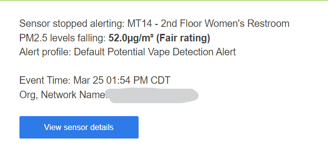

OK, let me append my initial post. Just this morning I made the switch over from battery power to POE. I toggle the switch over to "high sampling mode."  Truthfully, I've been getting so many alerts in battery mode, that every time I saw the phrase "sensor stopped alert," I assumed it was because it went offline.
Now that I'm looking at it,  I'm seeing that the alerts are telling me when levels are rising and falling.

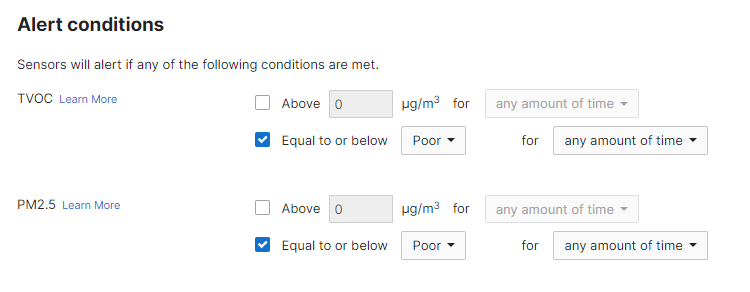

What we truly want is to know if/when we are above a certain level. Is that the distinction between the two check boxes for both TVOC and PM2.5?
Here are my current Alert conditions:
Here is the Alert I've been getting, but it may be because I have my thresholds set to be too sensitive. I'm getting them every 20 to 30 minutes.

Ryan_Miles
Yes, you would want to adjust the alert profile config if you're getting too many alerts. With the config you have shared you would get an alert each time TVOC or PM2.5 are equal to or below "Poor". The metric/value for Poor can be found in the dashboard if you click on the Learn more link next to TVCO and PM2.5.
https://documentation.meraki.com/MT/MT_General_Articles/MT14_Metrics_Explained#PM2.5_(.CE.BCg.2Fm3)
The two common ways to lessen alert triggering is configure a time period the condition must be met for or change the alert value itself. Changing the time period will help if the threshold crossing is temporary/short lived. Or, changing the metric value as you mentioned will create lower or higher thresholds that need to be met in order to trigger the alert.
Everyone's environment is different so you need to test and adjust to suit your specific deployment.
Ryan
