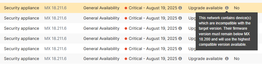

A number of our older MX devices (MX64 and MX100) got flagged with "Firmware status: critical". The "critical" part: what is it about?
  • something specific the firmware updates are addressing (like zero day vulnerabilities)
  • just the fact that the devices cannot be upgraded to newer version because of support sunsetting? Aka "you are generally vulnerable because you can't update the firmware and we here at Meraki believe it's critical"?
(If it's the latter, is "critical" really the right term? Maybe I am nitpicking - yet doesn't "critical" usually refer to immediate threats? Wouldn't a "warning" or an "end of support" label be more appropriate?)
I don't see anything in the release notes or changelogs for the new firmware upgrades listing CVEs or critical vulnerabilities addressed - did I miss them?
Firmware status: critical: NN networks
Your firmware is out of date and may have security vulnerabilities and/or lack key performance improvements. We highly recommend that you upgrade to the latest stable or latest beta firmware release.
This network contains device(s) which are incompatible with the target version. Their firmware version must remain below MX 18.200 and will use the highest compatible version available.
Thank you!
critical = past "End of Firmware Maintenance" date.
Cisco Meraki will no longer be maintaining this version.

Thanks - you probably mean this part:
Q: What does the date beside “Warning” and “Critical” mean?
A: This date is an End of Firmware Maintenance (EFM) date for that particular firmware version. Six months prior to this date, firmware will go into “Warning” status. Once the EFM has passed, the firmware will go into "Critical" status. We highly recommend updating the firmware before it reaches "Critical" status.

Our older devices are still getting upgraded MX 18.211.6 → MX 19.1.10 despite being "critical" and "ineligible". Grace period? Meraki's eternal kindness and generosity? UI and docs not being clear what "critical" or even "ineligible" really are - or perhaps me not understanding them?
