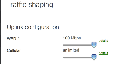

I was just looking at my test lab that is using a Z1 it now has firmware mx 13.28 and now on the traffic shaping page its says 1Gbps. I know this is different. I just hadn't though of checking it. Here is a screenshot from my dashboard. As far as clients, in the Spring of 2014 we had a lightening strike at school and took out my SonicWALL. I was able to put this little Z1 in its place with two VLANs and run the entire school for three weeks without a hitch. Our Internet speed at that time was only 15Mbps/15mbps. I didn't have any problems with around 100 to 200 clients per day. Can anyone provide a screenshot from a Z3?
@lesbarn This is from a Z3 running MX 14.21. From my testing it's definitely software limited to 100Mb.
This happened with the Z1's a few years back where they artificially limited it and then unlimited it. I understand the reason for limiting to protect your business on larger firewalls but these Z1's and Z3's shouldn't be limited. Though with that being said I'd love if they pulled the limit off the MX64.
