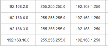

I have a client using an internet box with a dedicated public IP address , and in order to connect to his remote sites, he uses a VPN solution on another router on his LAN .
I will be replacing the first BOX with a new ISP BOX  and a meraki MX85 .
in the current situation, my client LAN  subnet is 192.168.1.0/24 so to connect to the remote sites he directs all traffic to the router on the LAN , via next hop 192.168.1.250/24.
the issue is that   have to put the same old config as it is on the MX .
LAN Subnet 192.168.1.0/24 and  static routes with the 192.168.1.250/24 as next hop .
but this is not possible since the Meraki sees the Next hop in the LAN and doesn't allow the creation of the routes.
Is there any way I can overcome this without changing the next hop on that router on the LAN and without changing the LAN subnet on the MX ?

Your static route does not make sense. What is the destination subnet or IP?
MariamT
he has many routes to remote sites  /24  using this nexthop.
the 192.168.1.250 is used by another router on the LAN that has the vpn solution on it .
and the LAN  of this site is also 192.168.1.0/24 , so When Meraki wants to create the route sees that the next hop belong to the LAN and then can't validate it .

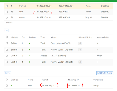

I've performed a test here and worked as expected.
MariamT
ooh ok thank you , I'll try that again .
I'v been getting this message saying that the route overlaps with a vlan on the MX .
