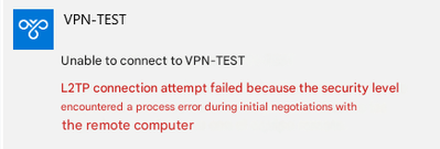

Hi team, I'm reaching out for your expertise. I'm having an issue with the Meraki VPN client.
We have two MX64 <-MS <- MR connected to Windows 10 laptops. We configured it according to Meraki's guides, but it's displaying the following message:
The strange thing is that we've also configured it on macOS, and it works perfectly; the connection is successful.
I see some posts indicating that it's due to a Windows update, but those posts are three years old 2022-2023. I don't know if anyone is still experiencing this problem in 2026.
Regards

this error 789

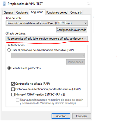

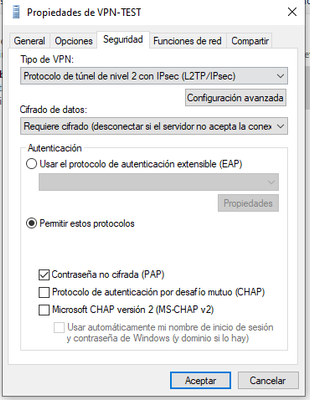

Adapter VPN-Test (spanish) - is correct?
Change the option highlighted in red to not require a cryptography, set as optional.

the problem persists
