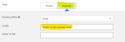

In your case, I don't see why leave it on trunk, so you can configure access on the desired VLAN.

as previously highlighted, change the switchport types from Trunk to Access and then assign the required VLAN number to each port
