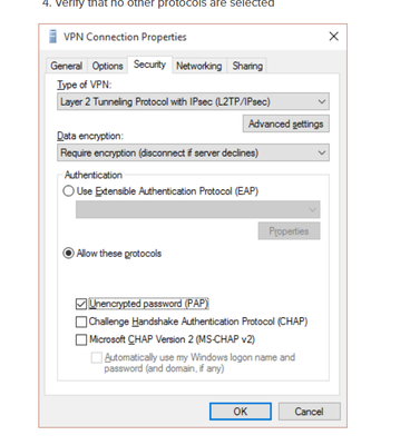

Check the connection properties.
https://documentation.meraki.com/MX/Client_VPN/Client_VPN_OS_Configuration#Windows
You can also check this.

I tried VPN Connection Properties as on your screenshot but still the same error.

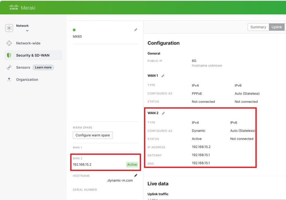

So the server IP is wrong or this MX is behind a NAT.

I think you may be right.
This looks like the Meraki device behind a provider's router.
In this case can I use dynamic hostname instead or it wouldn't work either?

I would suggest that your request the provider to configure a port forward on his router to your device using the ports 500 and 4500.
There's another solution that you may use, the Cisco Anyconnect that may be more simple to configure.

If your MX is sitting behind a NATed connection, you'll need an extra registry entry to allow the VPN to work.  I have a VPN config wizard which creates a powershell script.  Run that to configure client VPN on any Windows machines machine you want.  They should make it work.
https://www.ifm.net.nz/cookbooks/meraki-client-vpn.html
The iPhone - if it is using a carrier doing CGNAT it may never work.
If you want a solution that will work 99.999% of the time, but a licence for Cisco Secure Client (used to be called AnyConnect), and use that instead.
