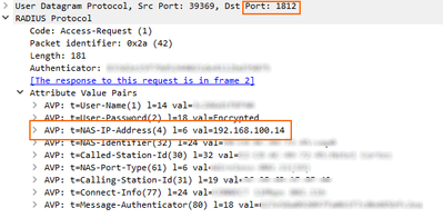

Further, you can confirm the IP address that the switches are using to communicate with the RADIUS server by taking a packet capture (filtered for UDP port 1812 on whichever port is connecting to the RADIUS server) while attempting to authenticate a network client. Then look at the "NAS-IP-Address" attribute field for each switch:
It'll likely just be the management IP address, but if you're using Layer 3 routing on the switches, it might be good idea to confirm.
