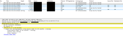

Below is the screenshot from the MX's packet capture (pcap file). I observed a missing Sequence in the ESP (Encapsulating Security Payload). I’m uncertain whether this could be the cause of the issue.:

It looks like your IKE SA's are quickly terminated from your second connection on.
There could be a strange state of one of the sides (firewalls) where they don't want to keep connections open anymore. It also takes alot of time to reestablish a new IKE SA after closing the previous one. It normally should take just a second, not over a minute.
It might be an idea to reboot the devices on both ends in a window.
Also please check the lifetime values on both ends (you could try a half day or a full day for the IKE SA and make sure all your networks match exactly at both ends.

The logs can indeed only give you insight into the timings of the establishments and tear downs of each tunnel. Also when obvious errors are present you will get logging of it.
The only thing you can do is do extensive packet captures on the WAN side of your MX while filtering on port 500 or port 4500. You can see what devices does what and when.
However after the key negotiation every exchange is encrypted you are left guessing by seeing what device initiated something or killed something.
