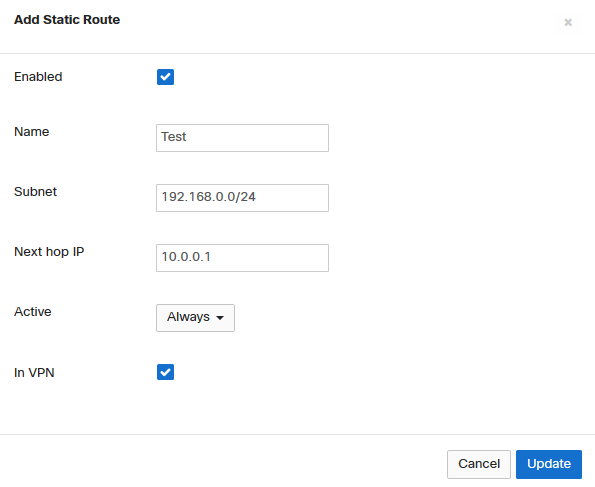

Hi Phil,
normaly you should be able to achive this, by adding the desired networks into the Security Assosiations (SA) of the MX84. So you need to have a route for these networks under Addressing and VLAN in the MX84. This way you can set them in you SAs on MX84 site so they are published to the MX68.
Steps:
- Add networks you want to reach on MX84 under Addressing and VLANs
- set the in VPN marker
Then you should be able to remove the "default GW" and be able to have the local internet breakout and reach your servers

Also, I assume I am adding the subnets from the spoke site (MX68) to the subnets section under addressing and vlans?
I think I worked out what you mean by "VPN marker". When I try to add a vlan for the destination network it wants me to add an ip for the mx, the router doesn't have an ip on this range so I am unsure what I should add.
Thanks for your time.

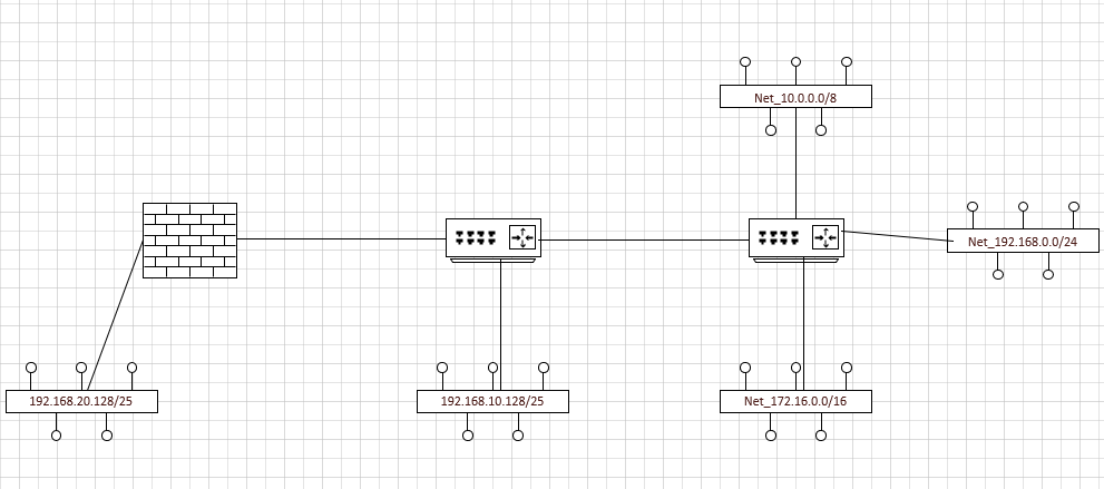

So by adding the route you say the meraki over which router it can reach this specific network. For example you got a router A and router B, router A has a route to B and knows which subnets are behind this specific router. Let's suppose your Meraki is behind router A. You need to let the Meraki know which subnets can be reached through router A, otherwise it only knows about the directly connected ones. I've made a little drawing to hopefully clear things up a little 🙂
If you take my drawing your routing table would look like this (with static routing):
Meraki:
192.168.10.128/25 -> Router A
192.168.0.0/24 -> Router A
172.16.0.0/16 -> Router A
10.0.0.0/8 -> Router A
192.168.20.128/25 -> directly connected
Router A (the left one):
192.168.10.128/25 -> directly connected
192.168.0.0/24 -> Router B
172.16.0.0/16 -> Router B
10.0.0.0/8 -> Router B
192.168.20.128/25 ->Meraki
Router B (the right one):
192.168.0.0/24 -> directly connected
172.16.0.0/16 -> directly connected
10.0.0.0/8 -> directly connected
192.168.20.128/25 -> Router A
And then you should be able to reach the Server 🙂
Have you already tried to ping the Server from the Meraki connected to the network of it?

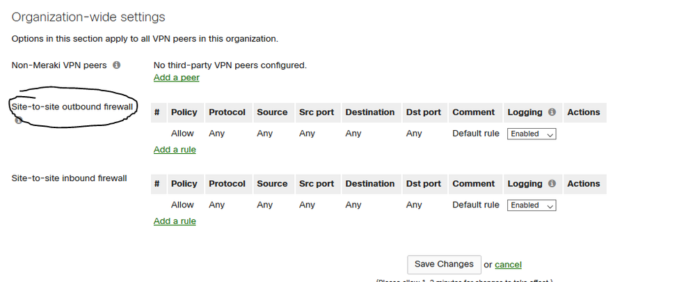

If the ping is possible you can add the Network to the Site-2-Site Firewall rules and this will create the route described above 🙂Firewall-rules.PNG
