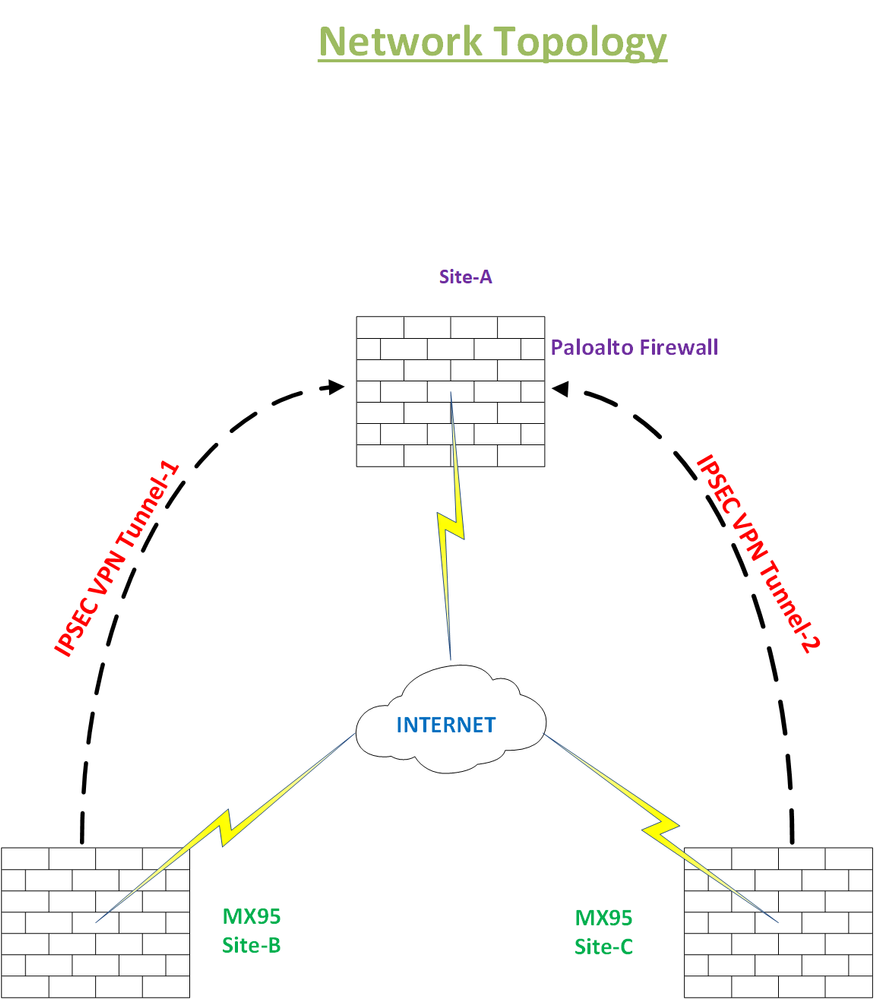

Dear Guys.
I am working on below given Network Topology. There are two different sites (Site B & Site C) and those sites need to be connected with 3rd site (Site A) via Site to Site VPN tunnel. Site B & Site C has Meraki MX95 and Site A has Paloalto.
All the Meraki products of Site B&C are added on a Single dashboard along with the licenses.
Site B is connected with Site A via IPsec VPN tunnel and all the Networks on remote sites are accessible.
The issue arises when we create the 2nd tunnel for Site C & Paloalto.
  1. It gives the warning message that Private subnets are already been defined in 1st tunnel. If the warning message is accepted than the 1st tunnel also goes down.
  2. Unable to create 2nd tunnel from site C to Paloalto.
Kindly guide how can the Site C tunnel be created.Network Topology Updated.png

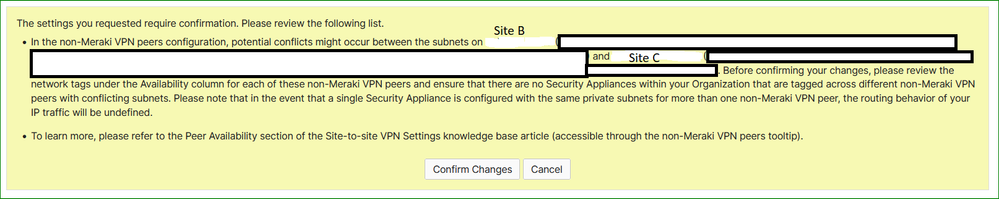

Can you show the message error and the configuration?
mumer1
Comes here often
You cannot configure more than one tunnel with the same private subnets.
But you can create just one tunnel for all networks.
