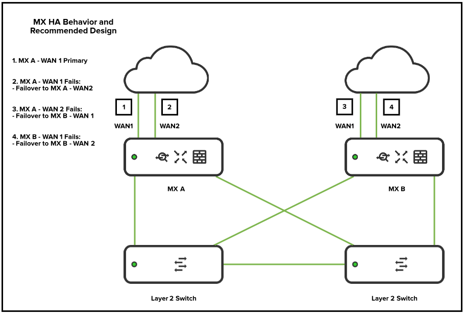

Hi All,
I have a question in regard to the warm spare failover process.
Here is the configuration:
2 Separate services - ISP 1 - 1GBPS. IPS 2 - 500MBPS
Primary MX - Uplink Port 1 from ISP 1. Uplink Port 2 from ISP 2.
Secondary MX - Uplink Port 1 from ISP 1. Uplink Port 2 from ISP 2.
I understand how failover works on the whole but I want to know what happens in this particular scenario. However unlikely it is, what happens if I lose the Uplink on Primary MX 1 Port 1?
Does it failover to Primary MX 1 Port 2, or does it failover to Secondary MX 1 Port 1?
The reason I ask is that obviously if the 1GBPS service is still available on the secondary port 1, we'd ideally like to use this rather than the 500mbps service on the Primary MX on Port 2.
Any advise would be much appreciated.
Thanks
NolanHerring
Out of curiosity, which model are you using?
Also assuming your using a vIP?
The primary MX (if it is up) will always be the path taken. The secondary MX only gets used if the primary device is goes down and VRRP packets stop flowing from it.
Meaning if WAN 1 goes down on Primary, WAN 2 on primary will take over.
Reference doc:
https://documentation.meraki.com/MX/Deployment_Guides/MX_Warm_Spare_-_High_Availability_Pair

NolanHerring
Reference doc:
Nolan Herring | nolanwifi.com
TwitterLinkedIn
