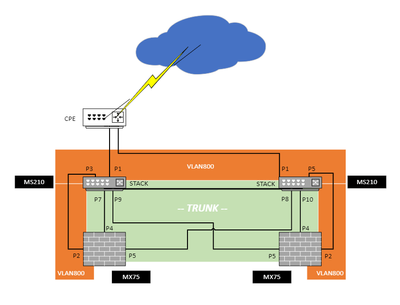

I was told recently that it should be no issue that have two MX75 in a HA (passive/ready) configuration with only 1 external IP address.
So I bought two MX75 and started configuring them.
As soon as I add the spare and set it to "MX IP", I rather immediately get a issue where it states that there is a duplicate IP configured and then the two firewalls takes turn on being primary/spare.
Is it so that this can't be done and I have to do it "old style" where each of the MX has there own external IP?
Are there any other options?
For reference I have connected it all as per following drawing:

It sounds like you're not configuring HA correctly. It's hard to tell from your diagram but do you have a LAN connection from both of the MX's to share VRRP heartbeats?
JFridolf-Iver
P2 on the MX is the "Internet 2" port (port 2)
These ports are then connected to each of the Switches
FW01-P2 > SW01-P3
FW02-P2 > SW02-P5
which is set to the same VLAN as the port containing the ISP (SW01-P1).
P4 and P5 on the MX are the "LAN ports", which are set to trunk as per usual.
So they go to each of the Core-switches
FW1-P4 > SW01-P7
FW1-P5 > SW02-P8
FW2-P4 > SW01-P9
FW2-P5 > SW02-P10
(STP to protect the network from loops)
