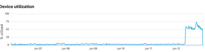

Summary Report  - This network doesn't report anything unusual on the device utilization ?
EngageTechNZ
Good call.
Seems quite high considering no-one is home during the day.

That looks like something that maxed out 1 CPU core, causing it to get hot.
I'll take a punt - software bug.  I suspect if you do nothing a future update will sort it.

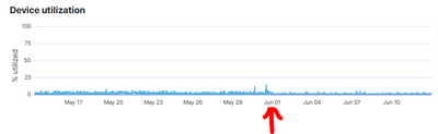

My MX75 is in the hallway and I haven't noticed that behaviour, but it is running 19.1.3 and has a very low reported utilisation:

Interestingly, you can see the load drop when I upgraded from 18.107.10 to 19.1.3 late  on 31st May:
ww
That should be because of the better use of resources/performance upgrade starting from 18.2 and up
