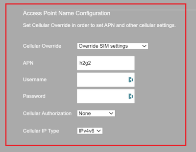

Hey Inderdeep,
Thanks for your quick response. I already followed that installation guide. The cellular connection shows "Ready":
However, once I disconnect the WAN connection, the router goes offline. I suspect that I need to specify an APN.
The SIM card I use is from Deutsche Telekom (congstar). Their support send me a link to their APNs: https://forum.congstar.de/Tarife/Tarif-Produktberatung/46325-Mobil-surfen-mit-congstar-manuelle-Eins... All of them require a username and password, which I cannot specify:
@klaus_heck : I think you need to use the override option for username and password for ASN
https://0x2142.com/meraki-mg-setting-up-merakis-new-lte-gateway/
The link you sent only applies to MG devices. The MX67C does not allow a cellular override.
It turned out that the LTE interface worked after a while without specifying any APN data. Why this took some time and did not work in the first place, is kind of a mystery. But it works now. Thank you for your help,.
