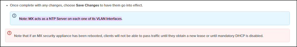

Hello All,
We are in an odd situation, where a recent penetration test indicated that our Meraki MX devices were running NTP servers on their internal interfaces. Upon inspection, we found this to be true. Here are the results of my NMAP scan.

I can find this documented anywhere. Does anyone else see this behavior? They are claiming it can be "timeroasted" which is false as its not part of our domain, but still was a curious find.

Mloraditch
I've also never seen any documentation for it, but have definitely been aware of it. Here's a thread in 2018 where someone points it out: https://community.meraki.com/t5/Switching/NTP-server/m-p/9551#M686
I can't find any references to where support can turn it off, but you could certainly ask if it's a concern.

Thanks for linking that post! Odd that its not documented anywhere, but it seems others also see this behavior.
I opened a ticket with Meraki support to see what they have to say as well. I will update the thread here when I find something.
I am not concerned, but my pen tester is claiming the NTP server is "leaking" machine account hashes, even though the MX is obviously not part of the domain. 🙃

BHC_RESORTS
Head in the Cloud
We discovered this as well in 2016. There was a problem with the time being incorrect. We opened a case and support said using the MX as an NTP server was not supported. We didn't want to use the NTP, it was just something we noticed.
