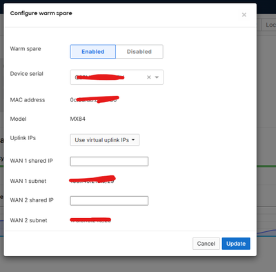

I'm looking for some advice in advance of me making a change to an existing MX HA pair.
They currently have WAN1 only connected using a public static IP on each and a public VIP.
Now I need to add WAN2, but this will be using private IP's and a private IP for its VIP (as the ISP router is NATting everything to a single public IP).
I cant see how to configure the VIP for WAN2.  I can configure each MX's WAN 2 IP but where do you set the VIP?

Thanks @Mloraditch
Not sure why I didn't see that!
So I guess set the WAN IP for the primary, then set WAN IP for spare, then do as you say above to set the VIP, correct?

Mloraditch
Click the pencil next to the Primary/Spare status on the main Appliance Status page, my example below is blank as I don't usually use them, but yours should  have W1 already filled out and you just add the IP to WAN 2

Thanks @Mloraditch
Mloraditch
Yes
