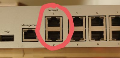

I'm adding a second ISP so we have a failover for our network. I see in the documentation where to add the second ISP's configuration information (SD-WAN Uplink). Presumably I need to connect the cable with the signal from the new ISP (which wasn’t stated in the documentation). I have the following questions that I did not find answers to in the documentation.

1. Taken from the following document:
The MX84 comes with two dedicated Internet ports, which are both configured through the Uplink configuration under the Local status tab.
https://documentation.meraki.com/MX/MX_Installation_Guides/MX84_Installation_Guide
2. You can set your Primary link under the SD-Wan and Traffic shaping page

Thanks to both of you. Exactly what I needed. Wish they let me choose both posts as the solution.
