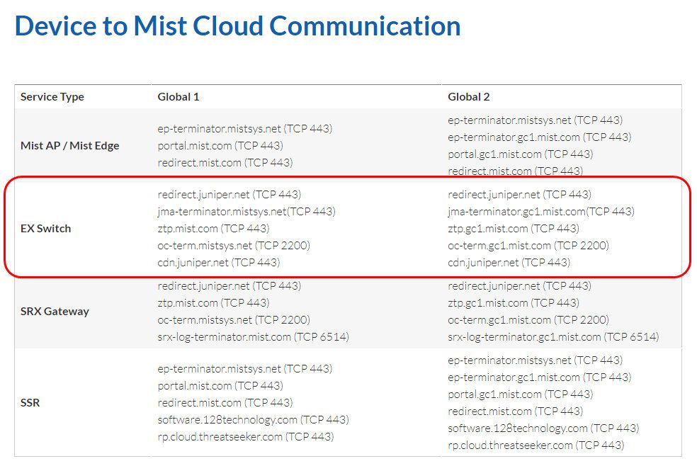

I have been debugging a problem for a week in the evenings with Juniper Mist Switches not connecting to cloud when behind Meraki MX 67.  19.1.3
Note: Mist Access Points are connecting Fine.
From the hardware Point of view they look connected (IE CLD Light solid white)  and the connection to 3.105.198.133:2200 shows  ESTABLISHED
Just he Cloud console show them disconnected

Looking at the packet capture  the Meraki does something to the packet at the  "SSH-2.0 Go"   part of the conversation  and the MIST server RESETS the TCP session.
