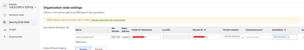

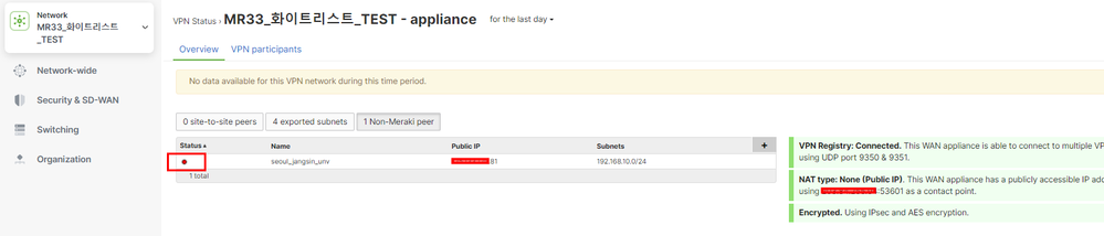

Hello @JJW. Please confirm that the "Public IP address/hostname" is the peer address of the far-end MX. Also, local IDs and Remote IDs may not be necessary depending on whether or not your MXs are behind another device and are being NAT'ed.

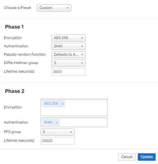

The Meraki side will be the simplest part of the configuration. You need to verify with the other party that their Config matches yours
Hello @JJW, one of the other things to be aware of is that you need to make sure that one (or more) subnets are enabled for VPN traffic. As @DarrenOC already noted, verification that the peer is configured with matching security parameters is necessary. I have included a link to our documentation should you require additional help. At the bottom of the page, there is also a link to our troubleshooting guide.
https://documentation.meraki.com/MX/Site-to-site_VPN/Site-to-Site_VPN_Settings
