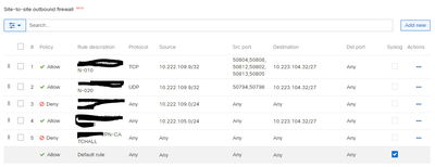

That is not the case - I have a rule that permits the return traffic outbound, followed by a deny any any from the local subnet to the remote subnet but incoming traffic on any port is still reaching the local subnet.
Here is what I have (10.223.104.32/27 is the remote (non-Meraki peer) subnet and 10.222.109.9 is a host on a local VLAN):
The rules should prevent incoming traffic to port 80 on 10.222.109.9, but they don't - I think its only checking the rules on outbound initiated connections, and not return traffic for already established inbound connections.
So, in the above config, how do I permit the inbound traffic I want whilst denying all other inbound?
