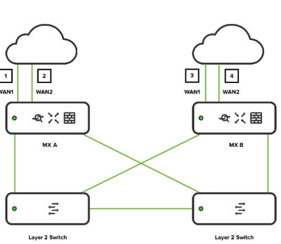

Following is the recommended design when you connect two MX using layer 2 switches in fully redundant mode.
