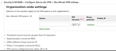

Try this setup.

Hi Alema,
We are using auto vpn setup for our every sites.
Refer the documentation.
https://documentation.meraki.com/General_Administration/Cross-Platform_Content/Meraki_Device_to_Clou...
