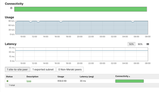

Hello,
Relatively new to the Meraki word and the MX devices. We created a site -to-site tunnel with an MX in another organization. The users have reported issues accessing resources on our end and trying to see what details we can get on the link. The VPN status usage & Latency on the MX seems to be an overall and seem to be unable to drill down into details on the specific peer link. Have I just been missing where to look?

BrentB
That is just it .. everything for a single day or for the past week has all been green. Thee are other Meraki devices such as Z1s or Z3s that are connected and have nothing from those end users. I was hoping to be able to isolate the specific tunnel and see if it would give me any usage or latency details as they say high latency would cause the issues they are facing.
RWelch
If you go into the VPN status page and select the PEER status it will show latency (avg) for that VPN.

BrentB
As far as we know the tunnel is working fine. I have green lights for status and I can ping across it. We just had someone come to us saying the access to our ERP system was seeing excessive errors and the errors they are seeing happen on lesser quality networks. They were asking for a review of packet loss and latency across the link. I unfortunately only have visibility of this side of the link as the other side is in a different organization.
