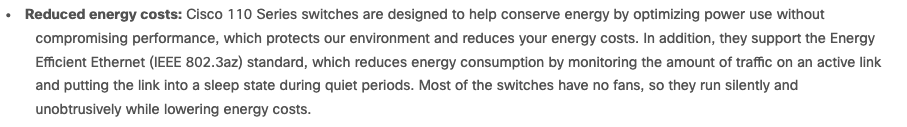

I just checked the SG110 and it supports EEE, so that may be your issue:

No problem. As I posted above, both of those switches you are using definitely support 802.3az (EEE), so that's likely the problem. Anything from the Cisco 2960-S family doesn't:
https://www.cisco.com/c/en/us/products/collateral/switches/catalyst-2960-s-series-switches/data_shee...
If you scroll down to standards, you'll see that 802.3az is not listed.
