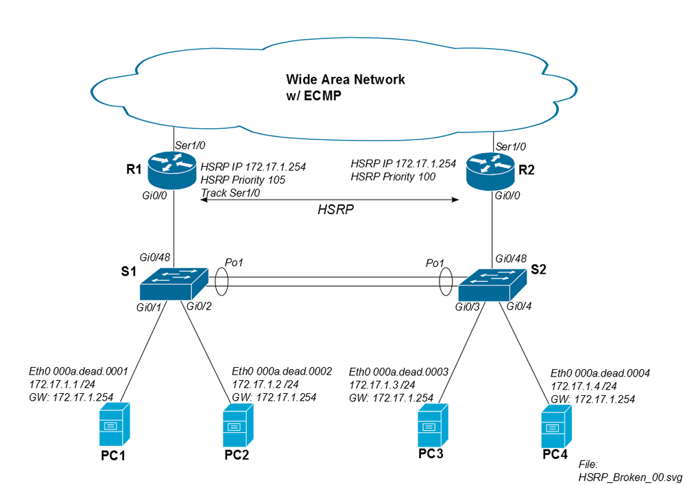

In risk of Necro posting on this thread, I need clarification of something.
What I am unclear of is if it is possible to use a configuration like below with a singe connection to each MX without using STP
This is a very common HA carrier solution with cisco and other vendors which I am told is not supported by Meraki
To Clarify, Meraki rep and other "Meraki specialists" are claiming that for this design to work there needs to be a full mesh and STP enabled between R1,R2,S1,S2 (The Meraki MX would be in place of the R1 and R2 in this diagram)
So instead of the diagram above with single link between each R1 and R2 there would need to be links from R1 to S1 and S2 and from R2 to S1 and S2 .
I don't understand why in Meraki's VRRP implementation there needs to be a full mesh on the lan side?
In Normal VRRP/HSRP design the heartbeat takes place on the configured subnet, if VRRP heartbeat fails then the backup will become master.
In testing we found this happened for VRRP (the gateway floated over correctly) but the Primary MX still stays active on the WAN side and return traffic from WAN side destined for LAN side arrived on the original primary which no longer "owned" the VRRP gateway.
This immediately seemed like a mis-configured implementation to me but after many meetings and being linked to some articles, it seems that unless the MX is completely dead, the Primary and Warm spare must always be able to heartbeat on VRRP to function correctly.
This goes against my core understanding of VRRP, as I said above I was expecting the MX to be smart enough to fail over the entire MX if a VRRP heartbeat is missed.

Bruce
@RW2, you’re correct in that the design you show will work fine if you have a complete MX failure. What that design doesn’t cover for is the failure of a link between the MX and the corresponding switch, or the failure of an entire switch. In any of these cases, as you correctly state, you lose the heartbeat between the switches, which means both MXs believe the other MX is dead and claim the ‘active’ state (and the associated IP addresses). Depending on the WAN side configuration, and whether you are using a VIP and SD-WAN, you may also see impacts with routing to the site itself.
This is the reason for the recommendation to mesh connect the MX and switches and use STP - it protects against the failure scenarios of a switch failing, or a link to a switch failing, and both MXs becoming active.
Its worth noting that the WAN side on the MX does not run VRRP, each MX has its own IP address, and if the MXs share a broadcast domain then they can also have a shared VIP address which is owned by the active MX. However, they work just as well without the shared VIP (and sometimes better). Remember that the standby MX never passes traffic, it only connects to the cloud for telemetry (hence why it still needs an IP address on the WAN port).

Bruce
@RW2, I actually believe that Meraki stating that the dedicated heartbeat link was no longer supported was a poor decision. I believe there are definitely situations where that direct MX to direct MX heartbeat link actually makes sense - the exact scenario you have being one of them (i.e. two switches, two MXs, one link from one MS to one MX, and then the same between the other MS and MX, and a link between the MS).
I don't know the exact reasoning for the recommendation but I'm guessing it stems from people implementing a dedicated heartbeat link with a dedicated VLAN - which doesn't work. The MX sends VRRP heartbeats on all VLAN interfaces and so long as at least one VLAN manages to pass the heartbeat from the active to the passive MX then the passive will stay passive (there is no per-VLAN failover). If you have a dedicated VLAN on the heartbeat link then this will keep the passive MX as the passive even if a switch downstream of the active MX has failed and its carrying all the other VLANs.
From what I can see, so long as all the links between the MS and MX, the two MS, and the two MXs are all trunks and carry the same VLANs then it should work - obviously consideration needs to be given to what @cmr said re. STP/BPDUs and convergence (although I'm not sure that ports configured as trunks immediately go into forwarding state, but never investigated this so not entirely sure). You'd also need to check how the STP is converging and which path traffic is taking (you really don't want the traffic between the switches going via the MXs), there's no real way to influence this other than switching physical ports around to get the convergence you want.
Anyway.... this is all my opinion, it still stands that Meraki don't actually support a direct MX to MX 'dedicated' heartbeat link.
