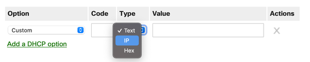

just to confirm, are you setting your Type as Text, IP or Hex:
RobertP
Yes I have set it as text.
